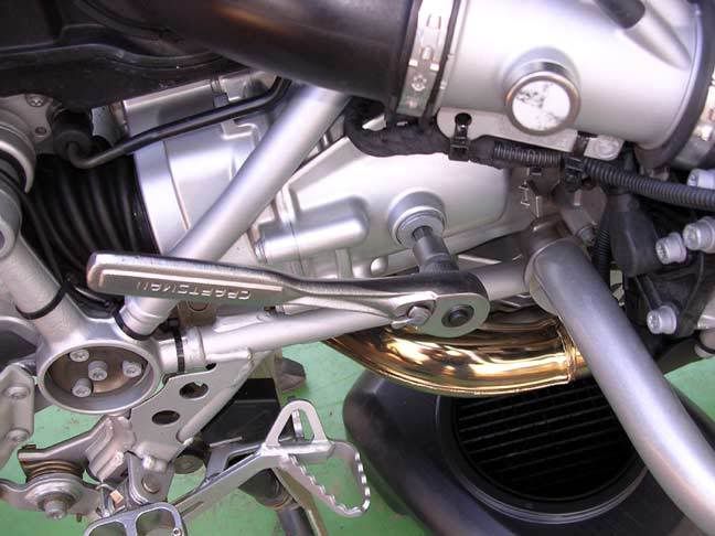

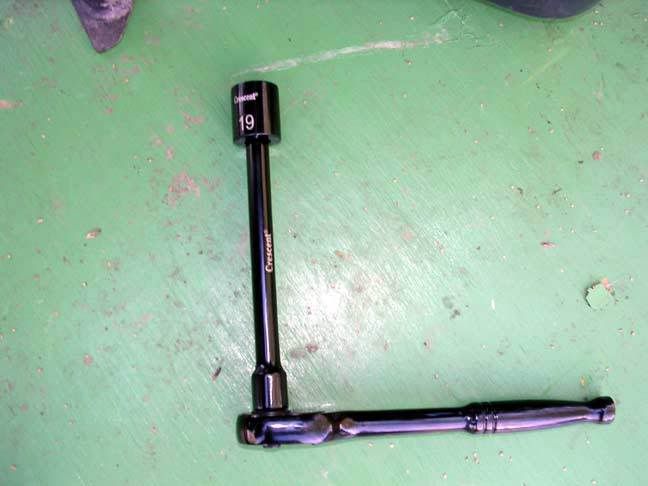

These are the tools that i used to change the tranny fluid.
A piece of thin Alum. for a funnel. The ratchet/socket are on the drain plug.
Self explanatory what's going on here.
