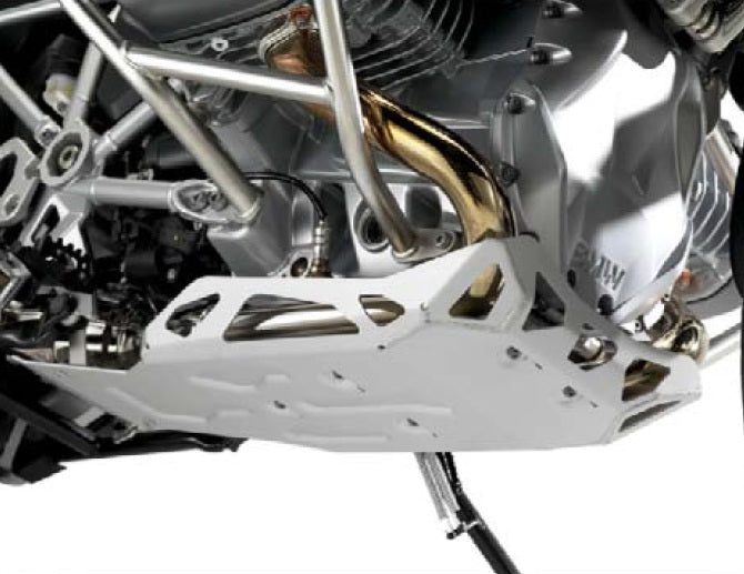

I found theses comparative pictures on the web (It is the SW Motech skid plate)
29045
29046

Here are a couple of photos of the difference.. (the small one is a 2020 GS stock one, the awesome looking one is the AltRider)
