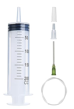

+1 on a large syringe from a farm supply store. 50 or 25cc, mark off how many times you fill it so you don’t lose track. Add a piece of clear tubing to give enough reach into the drive.

My experience with syringes is you have to be very careful with the amount of force you use to inject the oil as its easy to get splash back if you try to get the oil in too fast. You also have to clean the syringe really well with soap and water to remove the oil off the rubber seal on the plunger or it gets soft and mushy and will pull off the end of the plunger when you go to draw oil into the syringe.
